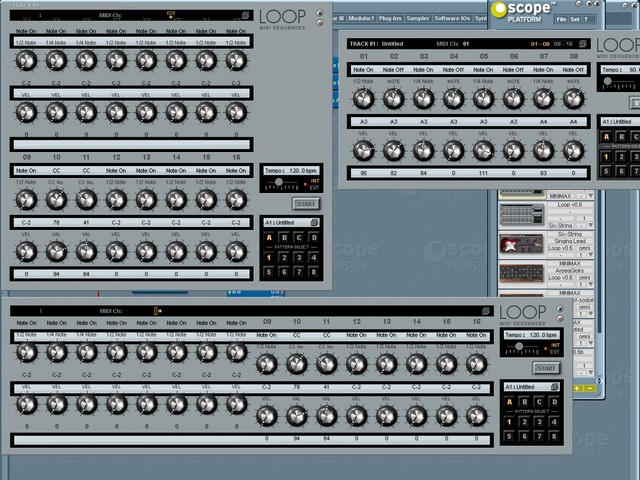

couldn't resist to test the unfold version straight away but I think there are some align issue in v0_6b ...
screen capture showing alignement trouble with Loop v0_6b on my 1280x960 display ...
Loop_v0_6b align trouble.jpg (114.73 KiB) Viewed 9409 times
Tested on a 1280x960 display with Scope 4
Upper Left and topdown are v0_6b with alignement trouble.
Topright is the former v0_6 with correct alignement ...
Screen resolution doesn't really matter actually.
Would be great additionnal feature though :D

HUROLURA wrote: Upper Left and topdown are v0_6b with alignement trouble.
Looks fine in Scope 5.1 for XITE-1. However, if I move knobs whilst a sequence is playing the sequencer just stops and has to be restarted (the Start button is still lit, so has to be switched off and on again).

HUROLURA wrote:couldn't resist to test the unfold version straight away but I think there are some align issue in v0_6b ...
OK I've figured out that's a bug in Standard mode. It works fine in Scope Classic mode.
Strange thing is the knobs which are moving position are the best aligned :-?.
I'll see what I can do with it :wink:
Mr Arkadin wrote:Looks fine in Scope 5.1 for XITE-1. However, if I move knobs whilst a sequence is playing the sequencer just stops and has to be restarted (the Start button is still lit, so has to be switched off and on again).
I've not been able to replicate this so far. Does the tempo LED stop blinking when this happens?
Do you have anything connected to LOOP MIDI in?
I have nothing on the input - this is when used in Internal clock mode. I have a Minimax on the MIDI output. I choose some random notes on the knobs to get a sequence going. Hit Start and all is fine. If I now start wiggling one of the Note On knobs to its lowest value (C-2) and up again eventually it will drone. Tempo light is still on and Start light is still on. Maybe wiggling is creating too much MIDI data?
sharc
Posts: 638
Re: LOOP - MIDI Sequencer v0.6b
Post by sharc »
Mr Arkadin wrote:I have nothing on the input - this is when used in Internal clock mode. I have a Minimax on the MIDI output. I choose some random notes on the knobs to get a sequence going. Hit Start and all is fine. If I now start wiggling one of the Note On knobs to its lowest value (C-2) and up again eventually it will drone. Tempo light is still on and Start light is still on. Maybe wiggling is creating too much MIDI data?
Ah yes, it's the same problem when switching patterns. Basically the changing of a note value will shift the key value of the note off accordingly. This means that if it's changed while the note is playing, the note off for the new note plays and the old note hangs. I'm working on a fix for it.
