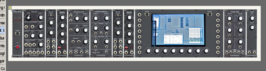

I just think this story will end up with a new modular hardware interface for Scope merging DSP and vintage analog sound in the most flexible way ...
CheerZ
Re: Hardware wavetable on an arduino
Posted: Tue Mar 23, 2010 7:29 am
by Neutron
wot, like that :)
Posted: Tue Mar 23, 2010 12:43 pm
by HUROLURA
Could be nice ...
Posted: Tue Mar 30, 2010 8:56 am
by David
Now that's jaw dropping and drool worthy
