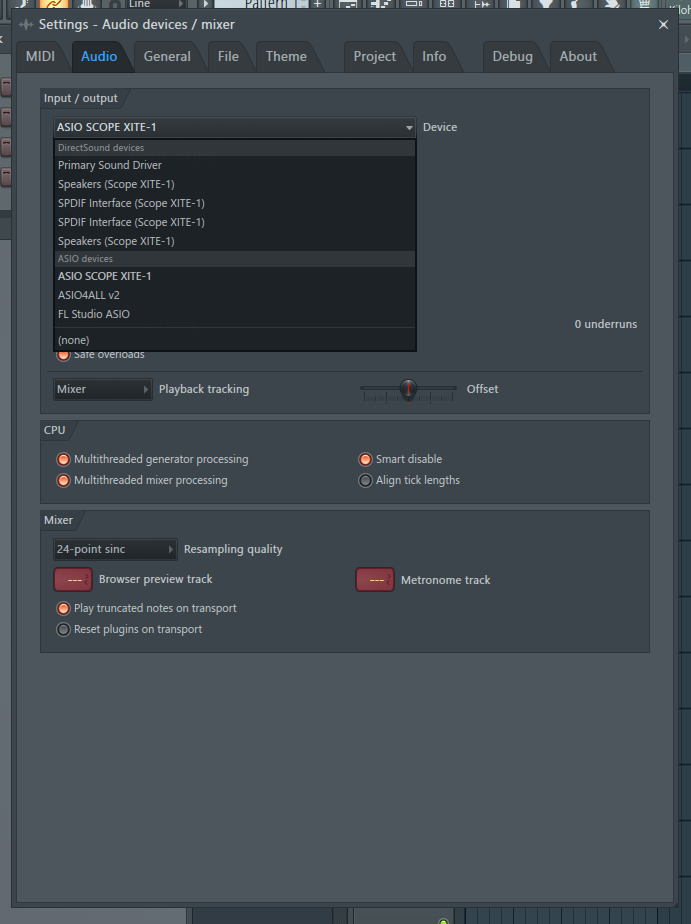

Why do you use ASIO4ALL when you have SCOPE/XITE and SCOPE ASIO ?Eiffel65Fan wrote: Mon May 15, 2023 4:38 am Thanks everybody for all the tips and advice, but for some very annoying reason, I still can’t get sound to come out properly.
...if I select ASIO4ALLv2 in the sequencer’s audio settings, the routing doesn’t get recognised by the sequencer.
It´s not necessary.
SCOPE ASIO2 modules work(ed) flawlessly for me and when using a DAW,- Win 7 Pro SP1, 32 and 64Bit and Win 10 Pro 64Bit.
I just only got some issues when using some standalone VSTis after these got updated by their manufacturers after Win7 wasn´t officially supported anymore ... p.ex. Arturia.
Some pops and clicks and graphic issues,- w/ just only a few of these plugins.
P.ex. Cherry Audio plugins work flawlessly standalone and w/ SCOPE ASIO,- most VSTis do.

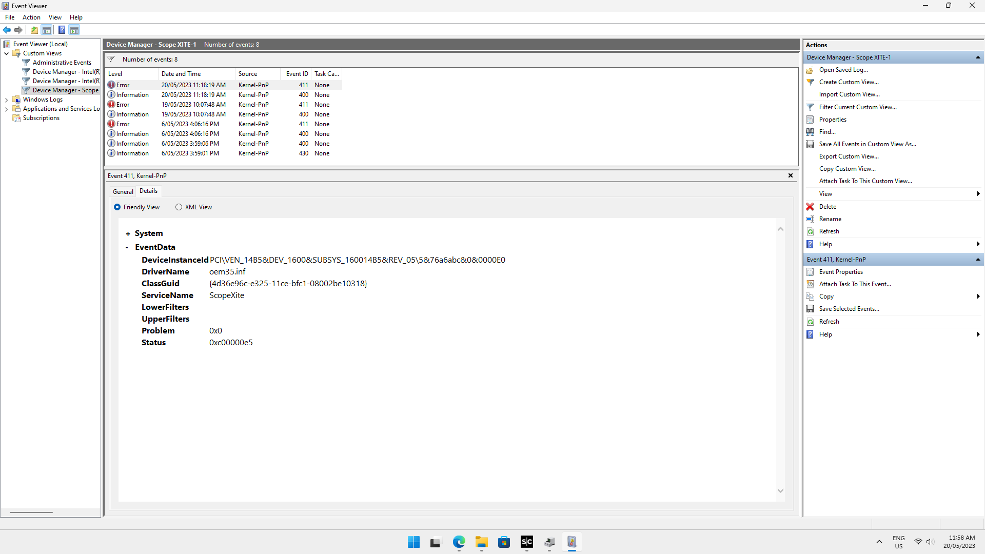

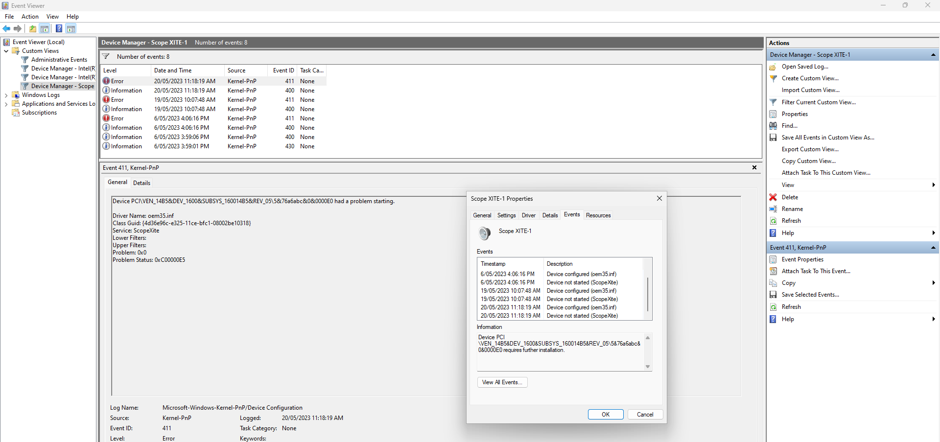

So, were you able to enter your BIOS and optimize the settings or not ?
S|C gave you installation instructions what to de-activate as also which Windows settings in regards of processor speed and energy savings like hibernation etc. have to be changed.
Scope PCI and XITE are not Windows soundcards and want the power of your machine for realtime audio/MIDI work.
As a PC user and for audio/MIDI work, you´ll HAVE to learn how to tweak your system yourself,- or pay an experienced DAW builder.
It´s not an Apple Mac where you plug in a USB and/or Thunderbolt cable connecting your audio interface and it works out of the box.
When your computer is well configurated, SCOPE works "out of the box" too once being installed correctly and launched.
Yes, there are some issues, but have in mind how many FX-, synth-, I/O-, tool- devices and modules come w/ stock SCOPE !
And don´t tell me your native VST plugins are all bug-free.
I´m pretty sure your issues are related to your ACER computer (only 1 PCIe slot !!!) and FL Studio 21.
I dunno how your BIOS looks like, but I own an Acer laptop which´s BIOS is so crippled there are not much settings possible at all.
I use it w/ Creamware NOAH EX,- and it was a lot of time investment and investigation to make it work.
Again ...
Install Windows, then configure your BIOS settings 1st,- download WinPrivacy and/or OO AShutUp10 and tweak Windows BEFORE installing SCOPE !
Once installed, double check if Scope ASIO and WAVE drivers appear in Windows audio settings as they should and check if SCOPE/XITE appears in Windows device manager as it should,- then try to use.
If there are performance issues, right-click Windows icon to the left of of the taskbar, go to "execute" and type MSinfo32.
Once done, go to "hardware ressources" > "conflicts/sharing" and have a look which devices share IRQ w/ Scope/XITE.
If there are USB controllers sharing, de-activate in BIOS and/or device manager in Windows.
Reboot and launch SCOPE.
When it doesn´t work at all, there´s still something wrong w/ your computer.

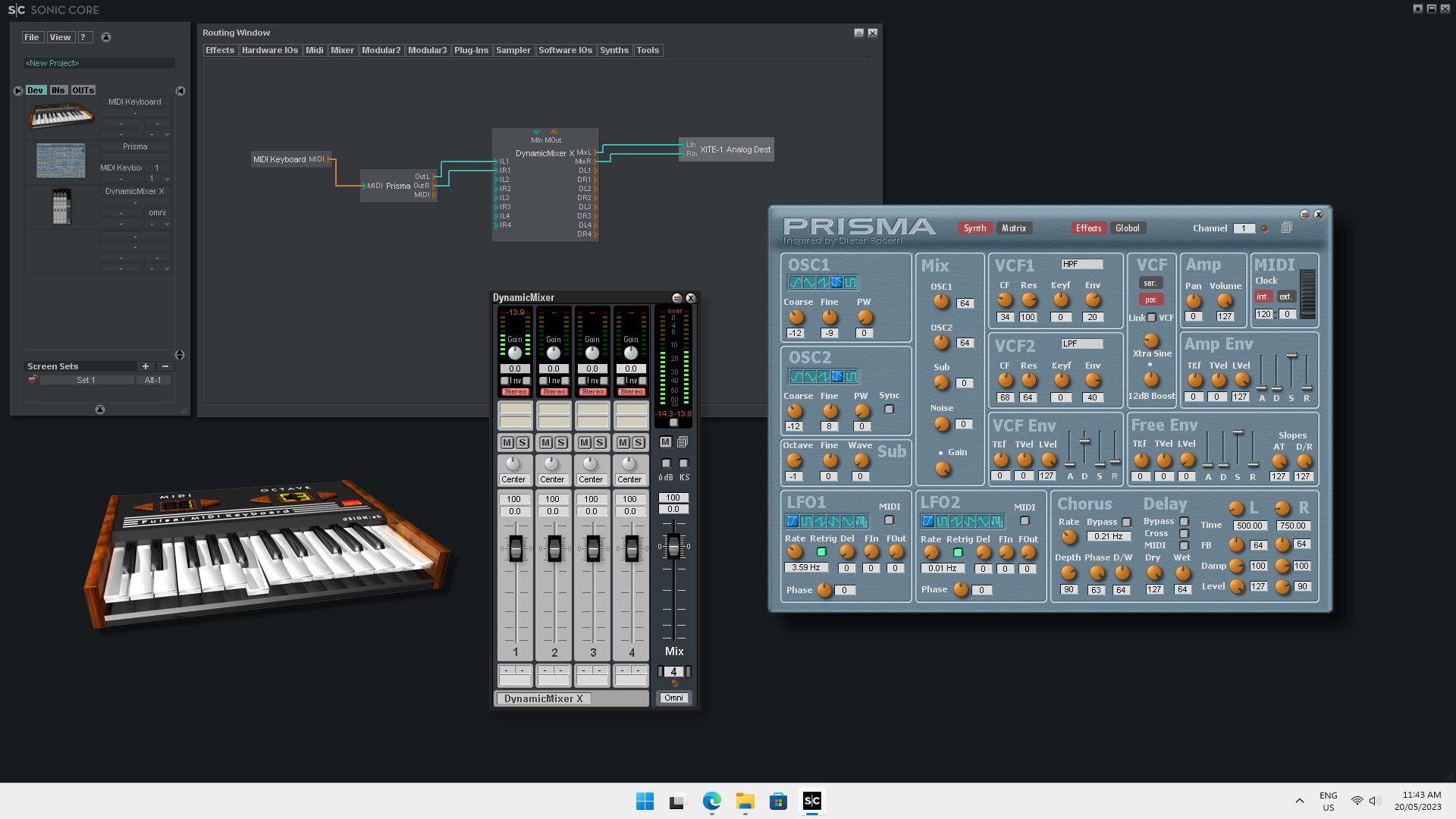

Here are some screenshots of my system to give everyone a better understanding of my problems.
Windows Audio:
with the Realtek Speakers disabled, and no SCOPE ASIO or Wave Drivers in sight.
My sound driver options in FL Studio 21:
and another screenshot:
My Scope routing test, in that instance I just want to test the audio in Scope without any DAW and go through the Prisma presets; this screen shot shows that a MIDI audio signal is coming out of the mixer when I click the keys, but no actual sound comes out. I have also tried it with the both ASIO 1 & 2 source/destinations, and the hardware source/destination, but still no sound comes out:

And in the Device Manager:

In your DAW apps (and all virtual instrument standalone devices),- the selected ASIO driver should be SCOPE XITE-1 !!!
Your XITE has it´s own IRQ and I don´t see any other conflicts,- so it´s installed correctly and should work.

I see FL Studio ASIO and ASIO4ALL in your ASIO driver selection window.
When you use XITE-1 as your one-and-only audio interface, delete at least ASIO4All.

the Windows settings don't matter except to browsers and other Windows devices.
what is the analog output on the XITE connected to? a mixer? powered speakers? an amp?
if you have sound in the mixer(proven by the meter) and the analog destination connected to the output of the mixer, sound MUST come out of the analog outs of the XITE. Windows is not involved in any way.

^^^^^garyb wrote: Sat May 20, 2023 9:22 am
THIS !

The only connections I have on my Xite are the Power Cable and the HDMI cable to the soundcard. Nothing else.garyb wrote: Sat May 20, 2023 9:22 am the Windows settings don't matter except to browsers and other Windows devices.

Unfortunately, even with all the Windows sound and (very limited) BIOS settings correctly configured, the privacy settings enabled, AND the energy saving settings at MAXIMUM, in ANY DAW that I attempt to open with the ASIO Scope Xite driver selected in the DAW’s audio settings (not the Speakers Scope Xite under DirectSound) with the ASIO2 Source and Dest modules in the Scope routing window, my computer STILL gets completely frozen and my cursor gets stuck (pressing Crtl Alt Delete and Crtl Shift ESC does NOTHING), so then I have to force restart the system by holding down the power button, ARGH! I even disabled my antivirus software and that still didn’t fix the problem!
The only thing I can think of that I’m doing wrong now is not doing the routing in the window correctly. For my next computer I will DEFINITELY be getting a custom built one with the recommended configuration settings (ASUS motherboard with Intel Core i7, 16 GB Kingston RAM, etc).
