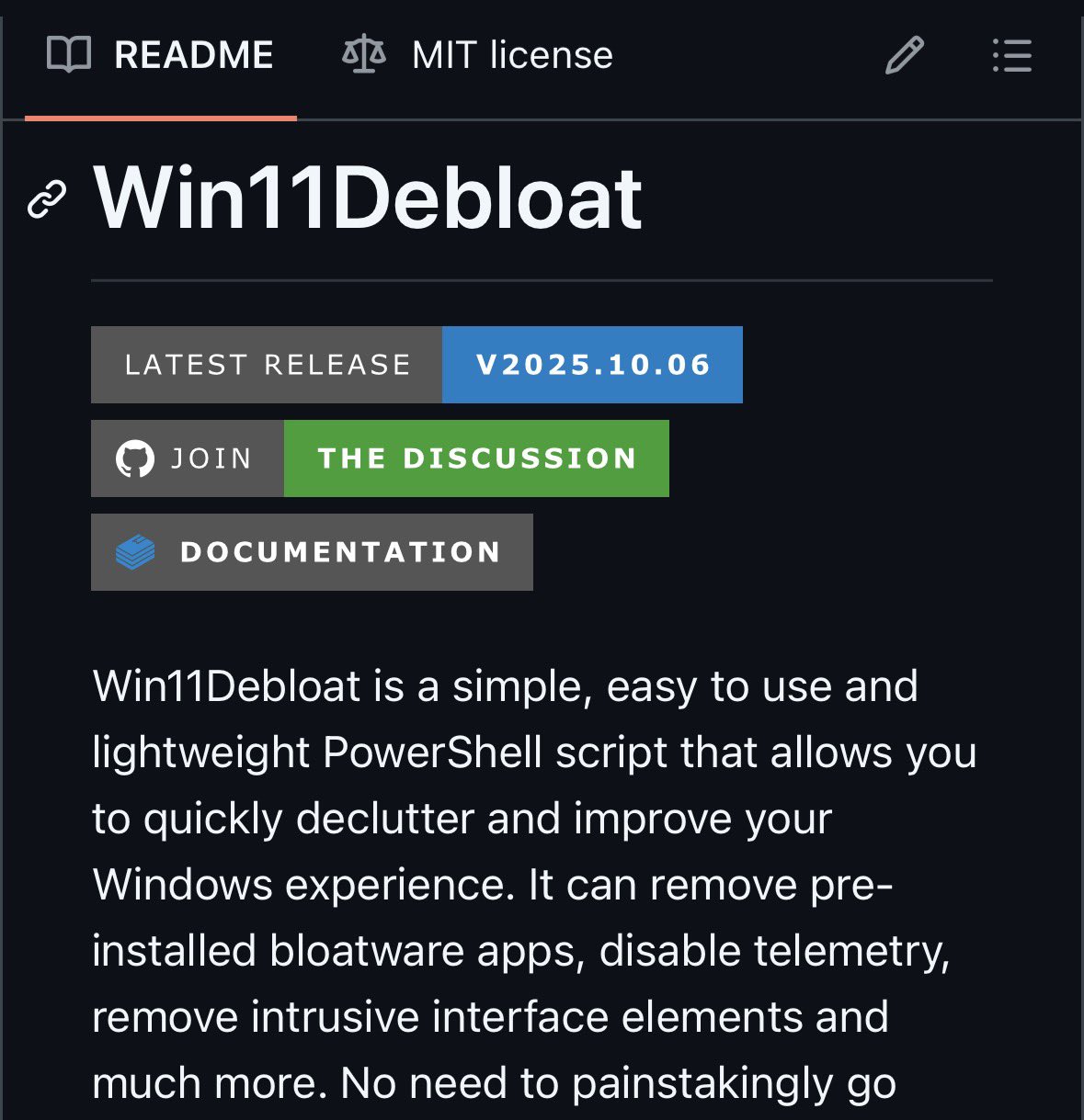

Win11DeBloat - A Lightweight Script to Tame Windows 11
Easily applied to an existing Win11 installation.
