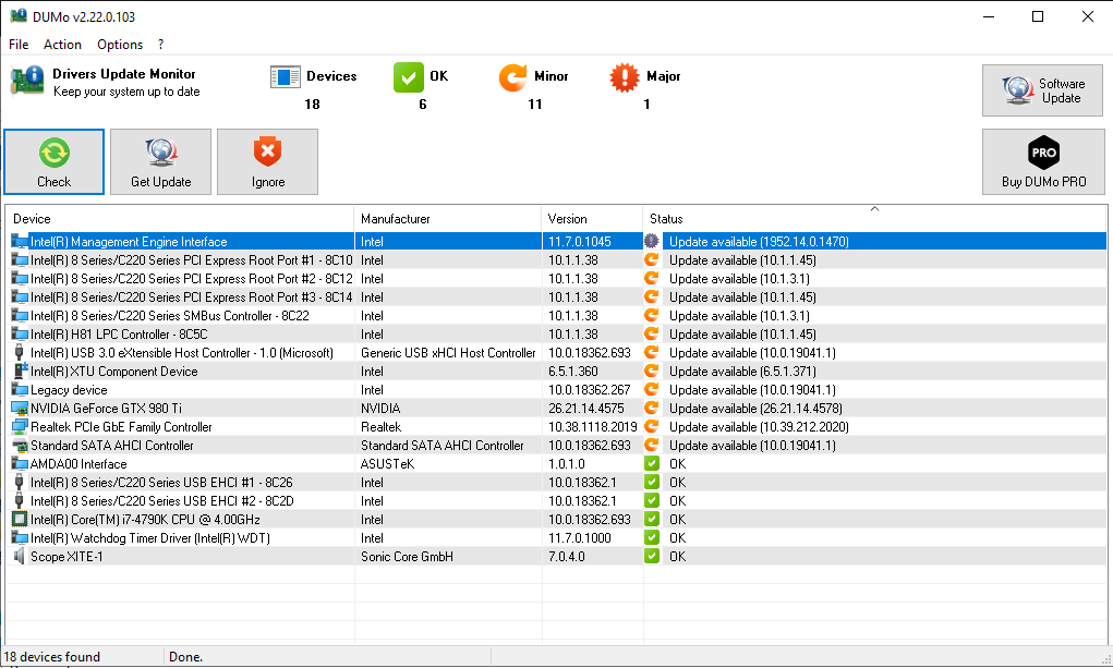

I ran Dumo and got this result:
I remember updating chipset drivers etc. years ago, but today I'm not sure what is right and important anymore?

the driver update might be.

Well, the newest chipset/MEI-driver I can find on Asus's website, is older than the one that Windows has installed by default.
The one that DUMo is poining at as the newest, I can't find on Intels website. The newest I can find on Intels website does not support my chipset (H81):
https://downloadcenter.intel.com/downlo ... product=53
When I run the Intel Driver & Support Assistant, which will check my system and look for the newest intel drivers that works for my system, I'm told that everything is up to date.
