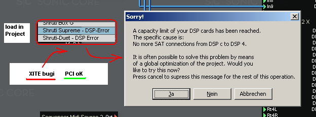

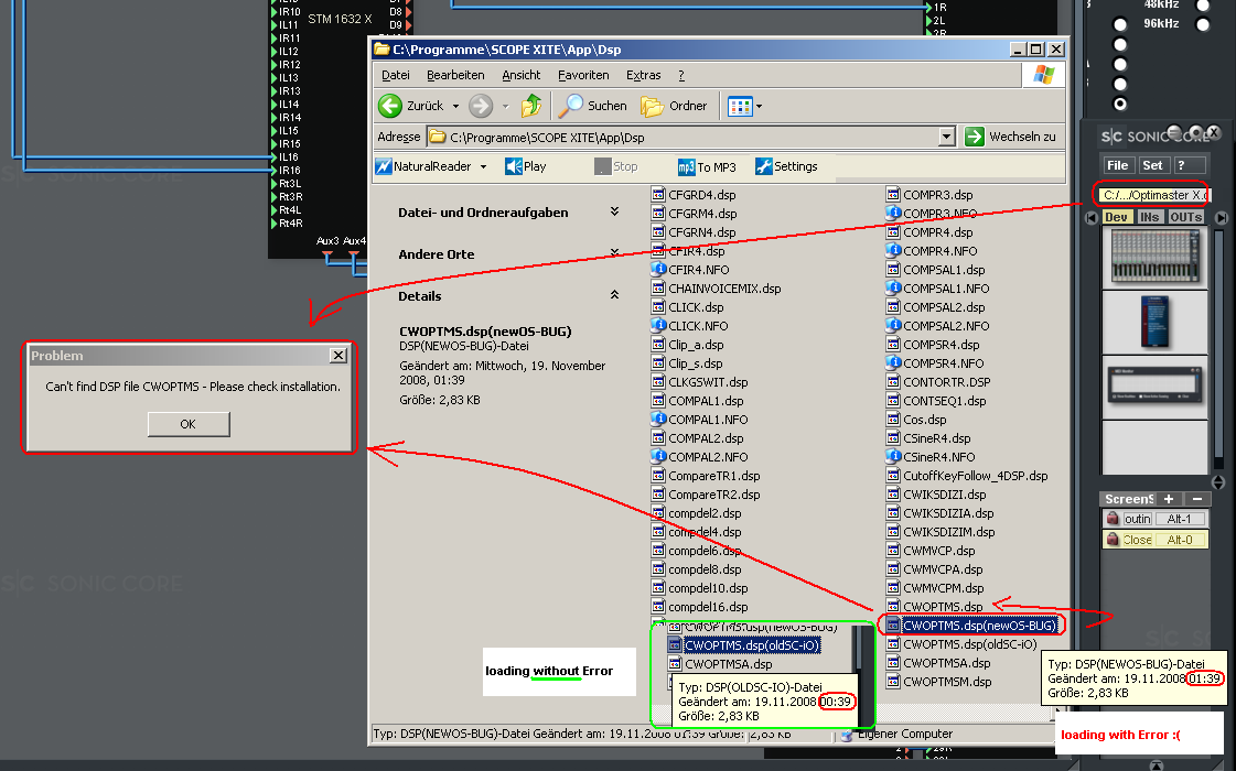

Bug Description:
hello faxi,
please, tell me what your setup do!!
(OS-Total-Bundle > all setup´s)
it crashed my lovely stable XITE-scope 5.1 installation
...and this is every horror to deBug... :cry:
for example:
what is the difference between the two example.dsp files except time of edit?
i can´t found it, but rollback can repair it ~ sometime yes sometime not
send me a list of your sc-edits to remake this with "try and error"
and please, no more setup.exe!!
every children can install scope-stuff manually ;)
and you can see, what and where you do!
thx and ROCK ON!
ps.: pci not tested yet with old projects... but i will now get nightmares, i think back to the zarg-install ~~~

here, only after OS installation, this message sent when load Optimaster X, no more tested yet
then, i rollback only the dsp-file from backup, now without message.
now jump between the two files and restarts
error < :evil: > ok
see here
the same horror was with zarg
http://forums.scopeusers.com/viewtopic.php?f=1&t=33936
is there a scope-system checklist bugi?
i'm confused, the file exists but is not found
... is the error in the file "dsp.idx" ???
example scope seti code:
ÜÜÜgaTT''++ must be corrected to ÄÄÄasMM"++ ...or so? :lol:
Re: Bug Reports
if it's xp, then usually the problem is that the dsp file has been marked "read only" when the "can't find dsp file" message appears. windows xp does make this decision in certain circumstances.
in a later windows os, it's usually a matter of administrator mode for the application.
beyond that, i've never seen this issue, nor have i ever seen the need to debug so deeply. it's interesting that you may have had a strange event twice. i'm baffled.

"read only"? ...ohh could be, will check this :wink:

checked, all files were and are writable

garyb wrote:...the Zarg plugins would need to be rebuilt considering those issues, but it depends on exactly how you use things. this really isn't the forum for this discussion, though.
mmh, don´t understand,
pleace see pic1
shruti-supreme and shruti-duet for XITE with SAT-problem... i think, dev´s are new?
Re: Bug Reports
there are only so many sat connections, period.
many things might max them. you can always mess with assignment of dsps to limit problems, but you only get what is physically possible with the processors.
http://www.hitfoundry.com/issue_07/xitemast.htm
http://www.hitfoundry.com/issue_22/dsp_mast.htm
