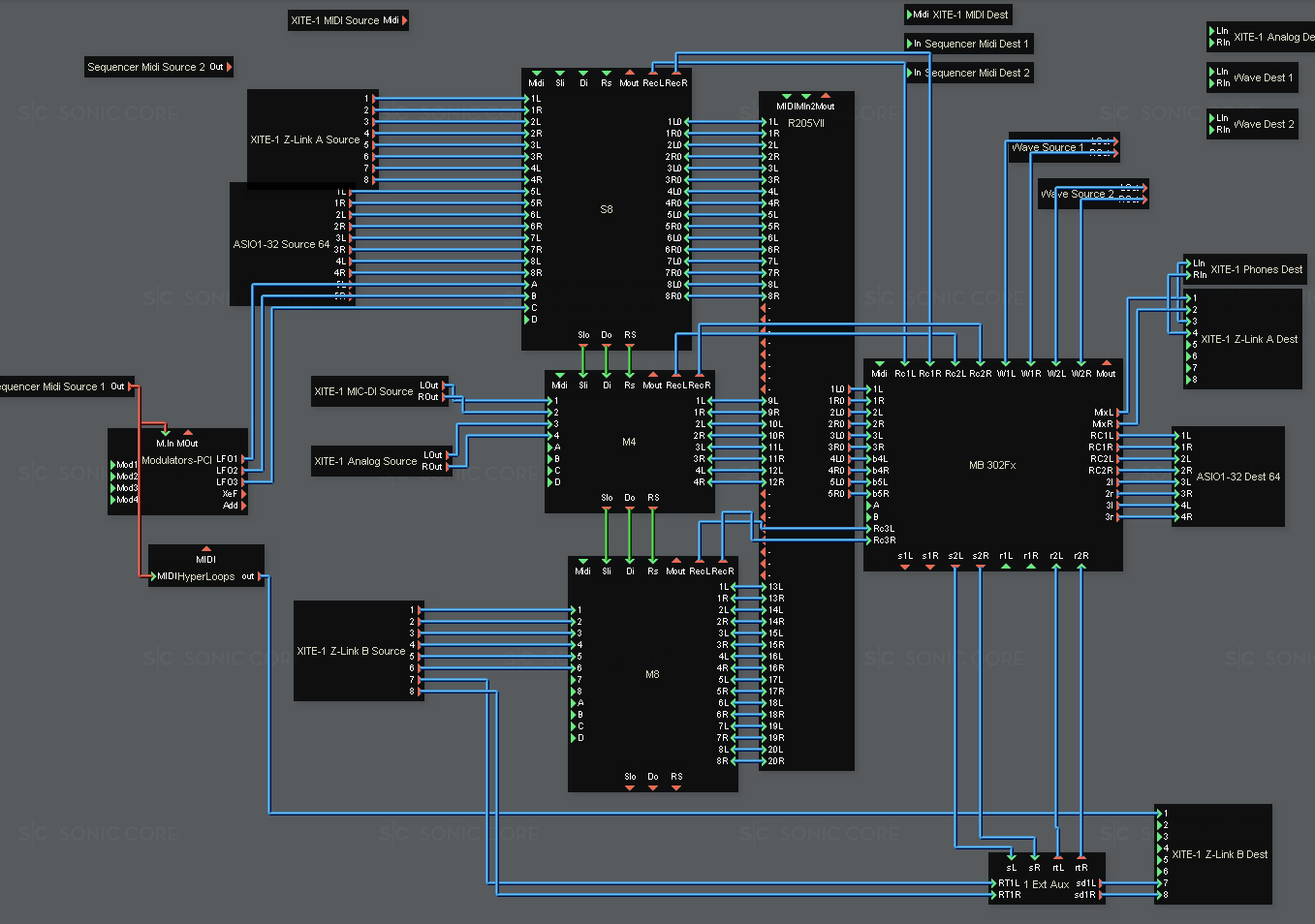

another example. 20 channel mixer with Modular Mixer V2 (will be available in 2 packs or more so you don't need to get everything if you don't want to - the pic below is made with modules from Pack 1 only).

David
Posts: 733
Location: Modular IV
Re: SpaceF Modular Mixer in 2016 (anyone using it with XITE1
Post by David »
Excellent looking mixer package - looking forward to all the new devices
