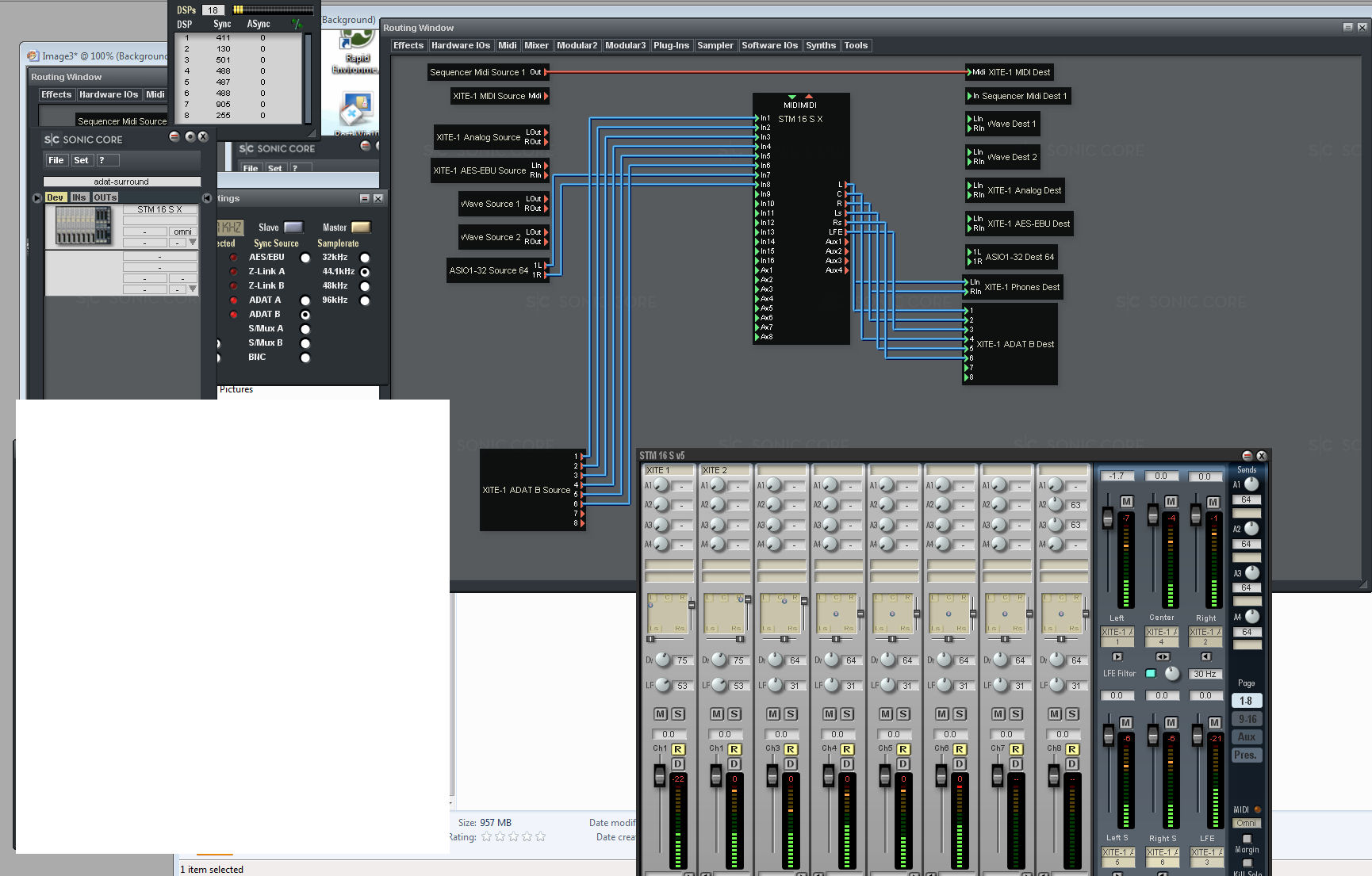

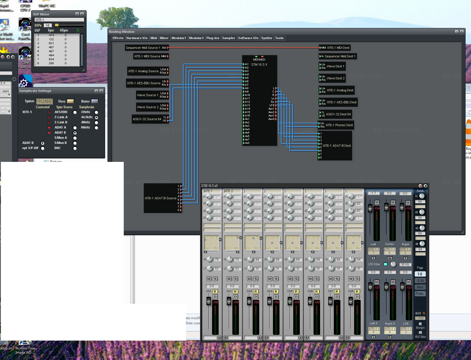

sure, slave should work. post a screenshot of the Scope samplerate window and routing window in each configuration, if you would. i'm sure that you're doing it right, but this should be much simpler. you shouldn't need to assign dsps or anything like that.
Re: with 6 inputs crackles at higher sample rates
Thanks, got it!
Slave mode: no audio
No answer from Holger or Juergen yet. Strange thing is, A16 should fold the channels if S/R > 48 , but nothing happens (audio is zero) in the short-cut (i.e. in connected directly to out).
master mode: audio
BNC works fine with external Wordclock.No answer from Holger or Juergen yet. Strange thing is, A16 should fold the channels if S/R > 48 , but nothing happens (audio is zero) in the short-cut (i.e. in connected directly to out).

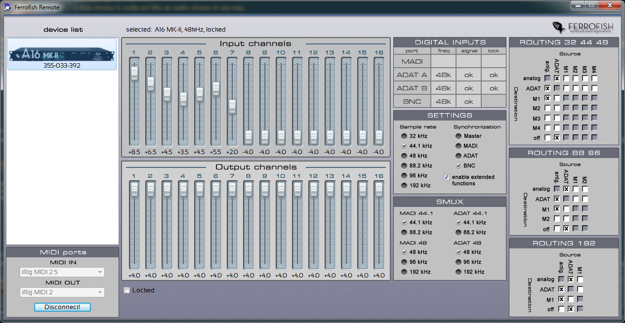

are you absolutely positive that the A16 is on the correct setting?
it would appear that something isn't working correctly, cable, A16 or XITE. just because i keep asking and haven't received a positive answer, you have both in and out cables connected, right? again, it's nearly unbelievable that both the a and b sections of both units would be defective.
these crackles are monitored at the inputs, not the recording, correct?

- A16.jpg (192.81 KiB) Viewed 9473 times
ADAT devices cannot produce audio with samplerates above 48k unless in S/MUX mode which uses 16 channels to produce 8 channels of audio(the 16 channel converter becomes an 8 channel converter).
i'm not sure what you mean by "At 32K and 44.1K the system is working fine. Even at 48K (with loopback on the A16) it's working up to 48K." that sounds like it's properly usable. you mean that it all works EXCEPT for the ADAT inputs from the A16, correct?
i don't know what synth or how many voices, but depending on circumstances, the DSP error might be normal. at high samplerates some of the heavier synths might need to be loaded to it's own DSP and voices might be limited. there are a number of different resources involved and of course, there's always a limit. right now, i'm just trying to understand the puzzling behavior that you describe. in the worst case, you can write me in support and i can arrange an RMA for testing.
perhaps someone else you know has an ADAT device that you can test with...
