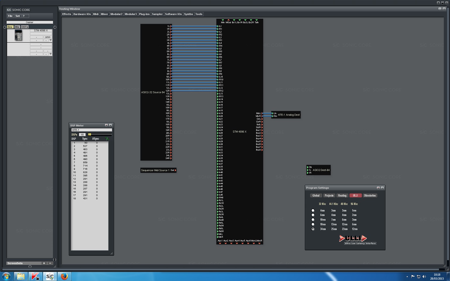

This is my default project:

Just a wild shot - have you tried a project with only 2 asio channels (minimal asio)?

petal wrote:Just a wild shot - have you tried a project with only 2 asio channels (minimal asio)?
Did you try this? I'm thinking that maybe having 24 stereo asio channels are too many for your system to handle?

I know it shouldn't be, still he is getting a 'PCI capacity limit reached' message.
