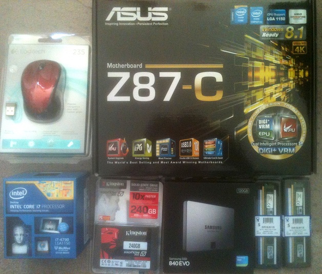

The i7 4790 came in and it was a bit cheaper than the 4770. A bit cheaper and a bit faster.
Heres the inventory so far (minus the rack casing) - next month, the build !
inventory
inventory

dante wrote:The i7 4790 came in and it was a bit cheaper than the 4770. A bit cheaper and a bit faster.
