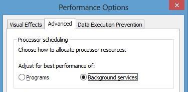

Posts: 5055
Re: pops and clicks xite -1d windows 7 64bit
Did you do this re background services ?
background processes
And what is ULLI set to ?
ShogunSpy
Posts: 313
Location: San Francisco
Post by ShogunSpy »
Thanks Dante. Yes I did and thanks for your webpage there's a lot of good info there.
