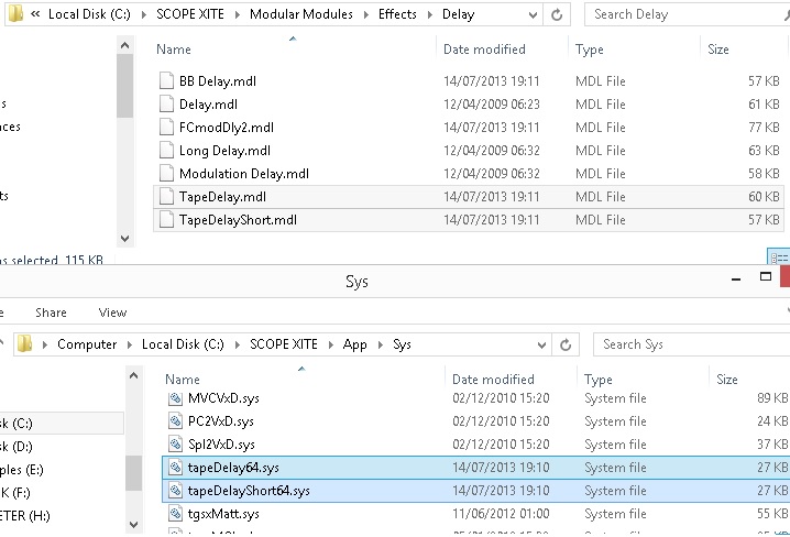

I can confirm Modular IV Tape Delay(s) working here on Win8 x64 Scope 5.1 XITE-1D once garyb's FTP download patch above has been applied - from there I got the tape delay sys and mdl files.
tape delays
tape delays
file paths
file paths
