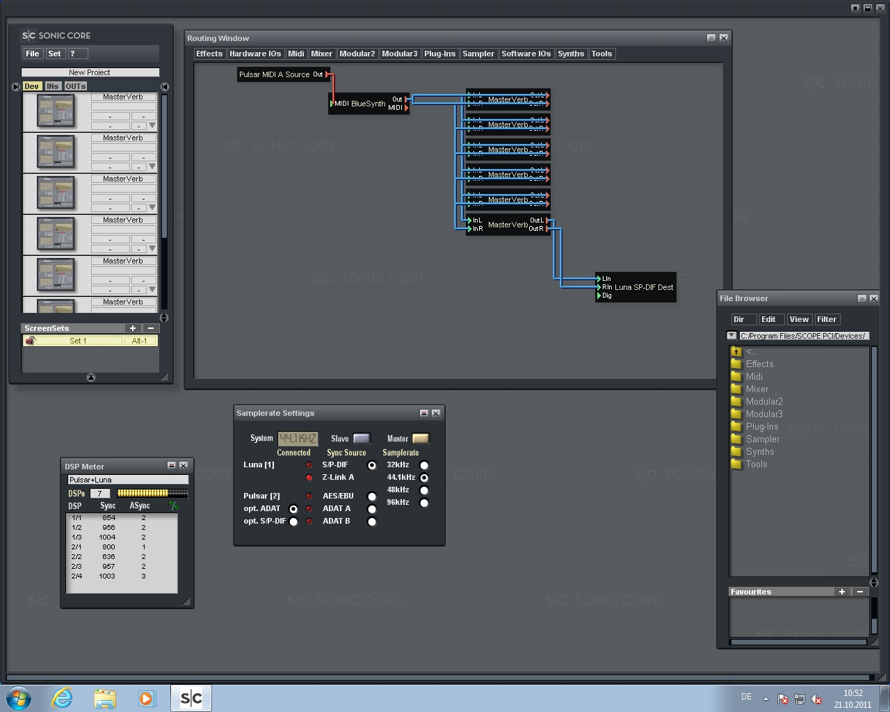

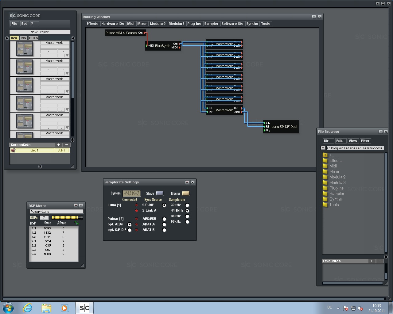

here is a screen of a REALLY cheap 2008 ABIT-board with an AMD Phenom X4 (first model) and 8 GB Ram,
Luna II + Pulsar I - Software 5.1, windows 7 x64...
6 Masterverbs + Bluesynth + Midi + Luna SP/DIF and
7 Masterverbs + Bluesynth + Midi + Luna SP/DIF
What's the point to buy the intel-things?!!?

i have bought a gigabyte because it was one of the two with 1366 chipset (i wanted a very fast pc!), triple channel and, most important, 3xPCI slots.thehe wrote:you guys are all totally strange...bosone wrote:i will be just happy to have 2 or 3 PCI S|C cards connected to my PC without losing PCI performances as i'm experiencing now with 1366 socket (5 masterverb). moving to 4+ cards is maybe not so worthwile....
you are buying intel - you pay a lot for the name...
then i learnt that the PCI performances was extremely poor both on 1366 and 1155 chipset. i should have bought a 1156 with 3xPCI! now i do not have time and money to change the PC: it works fine with win7 and sonar 8.5, and i can manage the PCI bandwidth limit even if can install just 2 S|C card (the third, for some strange reason, is not recognized!)
but if i could improve by spending a relative low amount of money and also install the other S|C card i have then it will be good!

ok.. so... Results:garyb wrote:pulsar1?
5-7 tops.
Machine 01 native: 7 Masterverb (little buggy... HARD LIMIT!)
Machine 02 native: 6 Masterverb - 7 unusable
Machine 01 PCIe: 6 Masterverb
Machine 02 PCIe: 6 Masterverb
Laptop ExpressCard: 6 Masterverb
All with Pulsar1 + Luna with a STDM made of old floppy-cables
Sounds good?

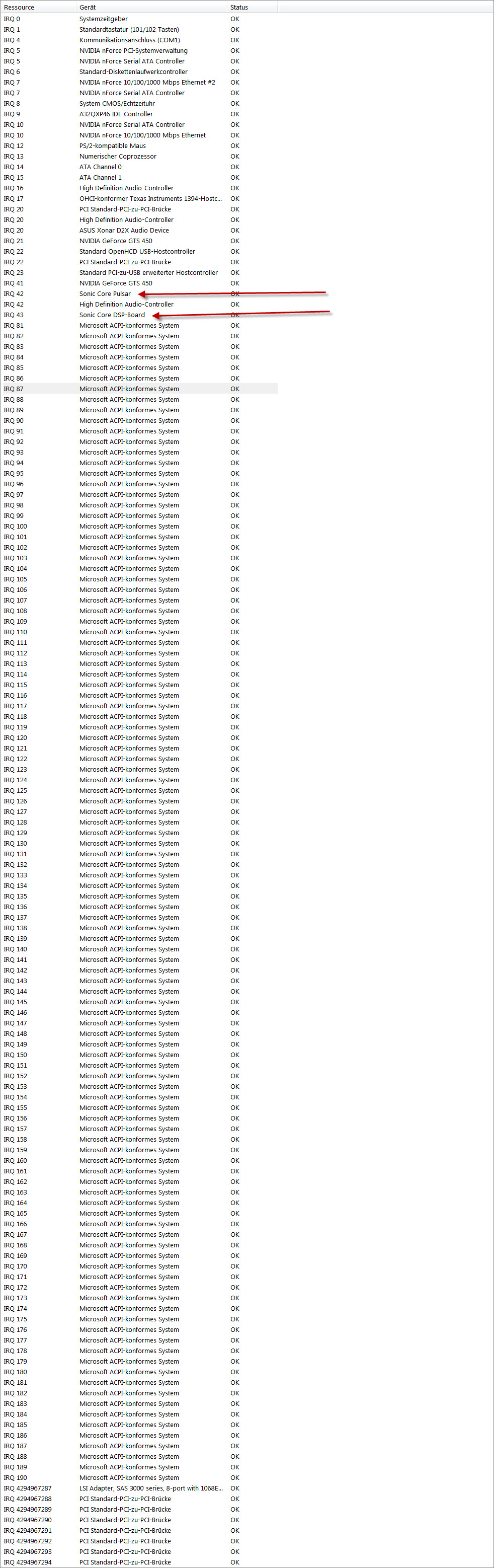

IRQ-Table:
see attachment...
looks nice, too...
so... GO GO GO for a good case design
see attachment...
looks nice, too...
