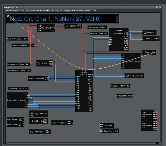

Will give this more time later this evening. Sometimes just need someone to bounce things off as I get "brain fade" - bounce! - When I press the keys on the KSP88 the MIDI monitor shows note number etc.... and value - When I move a knob or a fader is this meant to register in the MIDI monitor as controls are moved?

AL-A-LU-LE-U ..................... :D ----- I have assigned a control - What a bl***y miracle ---------------- :D
Not used all your gadgets yet - Project window was a nightmare - :lol: ...............Not the finished project yet tho----- 1 annoyance was the drivers seemed to keep "getting dropped" but I've plugged away and a breakthru has occured - wow I can't believe it ----------------gee........... :o

Hi Xite and others,
Here is the project to begin to incorporate MIDI controllers for the M-Audio Keystation Pro 88 - I've not used your 9k midi router yet but I just needed to get something to work and I'm on the right path - If you have suggestions maybe you do a project just like mine but add some modules in to make further improvements - Eventually It'll be worth it but I've had my doubts about making this work..... :lol: -

Well first off the Pulsar 2 MID SOurce on the top of the PWindow is fine, but the Pulsar Seq MIDI Source needs a FIlter before it goes to the merge, not after.
The reason is you want the option to have Filtering of the signals coming from the DAW.

Thats great Xite - When I'm on Scope next I'll do this and make changes nice n slowly so I can understand why etc....
It took me ages to get a connection and to end up with a "technically flawless" project in Scope will take a little time but when I'm there I'm there.....and if I know that the project is correctly connected if problems arise it is easier to troubleshoot. It will also be easier to work through this again so I can concentrate on getting the best out of Keystation Pro.
