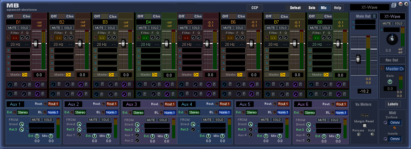

There are bigger modules in my modular mixer's builds, but for the moment, i think they are too big so i didn't continue their development...
later may be if i can try on xite what is good and not good...
but thanks for the pic, that's how I evaluate device panels too, before making them :-)

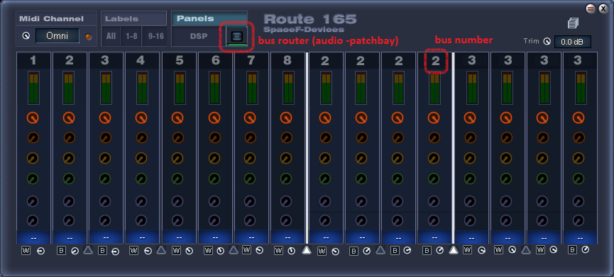

a dynamic router takes a bit more dsp than the classic aux send that i use on Modular Mixer, and which is the smallest possible router in scope.
A dynamic router is an aux send + a switch. A ModMixer bus send is just the aux send without the switch.
A router with 14 lines would take less dsp than 6 aux + 8 routing switches.
But I have an 8 dest switch for bussing (from the 36/12/8 i tried to make 3 years ago, but couldn't load it ;-)
You didn't say for how many input channels...
I personnally don't know if it is worth the effort of trying when it is possible that it does not work in xite :-/

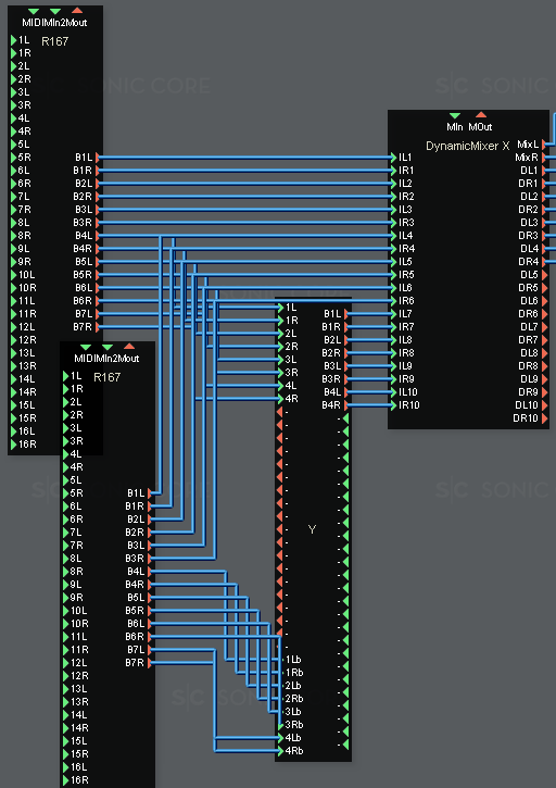

I've been playing more & more with the modular mixer, and had my "aha!" moment in DSP assignments last night. Some of it is due to just realizing the tips that Ralph had sent out over a year ago, some of it was just some other experience...
#1 - Like tjsound does, place your INPUTS on DSPs 7-10. These DSPs have more communication with DSP#1 and DSP#2, which control the Hardware and Software I/O. Placing your channels or inputs here means FAR less likely chance of SAT errors.
#2 - If you don't place the initial module, it will start piling things up on DSP#18...which has low latency between other DSPs, but has less SAT connections too. This will turn into a cascade of issues later in the project development. Don't let SCOPE do this first assignment for you, if you start placing mixers first thing. Once the first module is placed, SCOPE is smart enough to start placing overflow modules along 7-10.
#3 - Right-click/"Assign to DSP" works. But then the module you place next, will automatically get placed to the same DSP you just assigned. This can actually lead to DSP or SAT overflows, just during the assignment. Sometimes, you have to place/assign modules in empty DSPs, then re-assign them once you can see where the large connection buses are. Keeping large buses inside the same DSP means NO SAT errors.
#4 - Have your inputs in 7-10, then build the modular mixer toward DSP15. This leaves DSPs 10/14/18 to be the home of your effects (not as inserts, but wired in the project). These are low latency, so you won't add phase issues when layering effects on your dry signals (the round trip DSP-DSP to that last slot is about 4-8 cycles, and the DSP-DSP latency on other chips is...7-11 cycles. Minimal phase issues is nice.
Using this technique, I've built a 32-channel stereo mixer, with VCAs (for Compress/Gate/Expansion with Modulation) on EACH channel, 7 stereo AUX sends, 7 stereo buses, 1 Mix7, and 1 MB7 (this is a sub-mixer for my Aux effects, so effects can be chained here). ALL IN 2 DSPs. For those with Modular Mixer, that's:
(2) Side Chain 16
(2) Router 167
(2) Stem 167
(2) Merger Y16-16
(1) Mix7
(1) MB7
I'll play with this more, and probably add a channel in front of the SideChainers for EQ, Compression, etc. Until I played by the rules I listed, I was hitting SAT errors constantly. Once that happened, SCOPE would crash often (the application, not just DSP overloads). Last night I did a 5 hour jam, and had absolute stability. It seems that saturating DSP communications has a direct effect on XITE-1 stability. So get this part right, and the rest will be better.
Oh, if you start seeing "SAT Error, no more communication available between DSP 9 and DSP e", where the second DSP is listed as a letter instead of number...you know a crash is coming soon. SAVE YOUR PROJECT NOW.
I think similar rules apply to the MasterVerb, or any device that requires communication with the Host for processing: Place them in DSP 10 if possible...this is lowest latency, and also shares the high-count of SAT connections to DSP#2, where the communication to the Host PC happens. This will place a lesser burden on the resources of the system, so you can do more elsewhere in the project.
