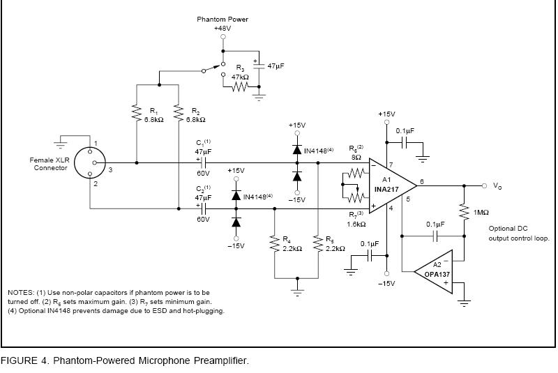

Kylie, the circuit was a simplified version of the one for a phantom-powered mic preamp in the datasheet for the Texas Instruments INA217 chip.
Re: Mic preamps - can YOU hear the $$$$ difference? (with audio)
Posted: Wed Mar 25, 2009 10:07 am
by Shroomz~>
There's more info on the implementation here >> giant killing $5 mic preamp its secrets revealed

The 5 bucks pricetag is a bit misleading, too. If I were about to build one, it would cost me another $5 for public traffic. I would spent at least half an hour to get the parts, another one to spend with the circuit board etc etc. The pile of batteries isn't for free either.
The project is inspiring for sure, but a bit polemic, tho ;)
On the other hand it's a good example to illustrate that a handful of rather cheapo parts will become quite 'expensive' if you're going to release them as an industrial grade product.
You need a case, powersupply, a safety certificate, additional parts for protection (that were stripped from the example), and staff to mount it, a distribution, bookkeeping, profit margins for resellers, advertisement and last but not least some profit for yourself... go figure... ;)
