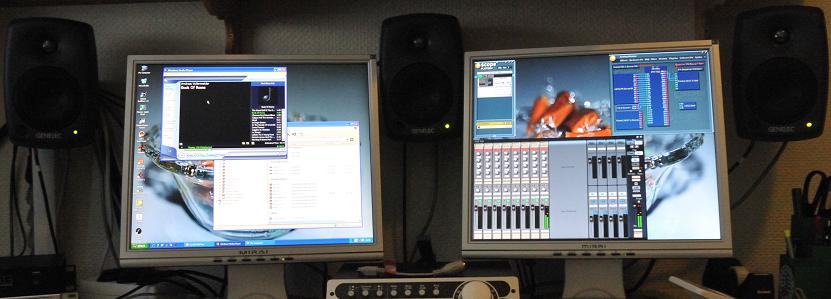

I added a wave source to the Scope project i've been using, and have played Mediaplayer for a long time now, and keep it playing some more hours.
0806_XXX Studio.jpg (60.99 KiB) Viewed 2955 times
