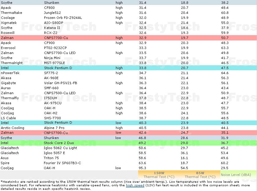

This table with data extracted from FrostyTech.com reports values for Scythe Shuriken, Zalman CNPS 7700 Cu, and Intel stock Pentium D and Core 2 Duo coolers.
In my system I have a rise of 22° - 23° C using the Zalman CNPS 7700 Cu with a Prescott 3Ghz (800 Mhz FSB) in idle state, and 44° - 45° C full load @ 20° C ambient temperature, but there's a 25 cm fan on the case side blowing toward the CPU cooler (at now it's manually speed regulated, but I'm experimenting with a circuit using a thermistor in these days)

Why that?garyb wrote:t.....i'll STFU now....
I installed the stock 775 fan with its clips just 1 time in the past; and the machine had thermal lock at the first startup. This because, following the instruction in the Asus manual, I installed the cooler with the MoBo already mounted in the case.
The pressure needed to lock the cooler was bending the board in a way I considered worrying, so it ended with one of the four feet inadvertently bad locked...
Then a friend of mine came to fix it (removing the board from the case).
Now, the Shuriken has clips like the stock one... I'm somehow worried for that...
stardust wrote:Wow I wouldnt accept any noise level beyond 20dBA and here the go 50+
http://www.frostytech.com/testmethod_mk2.cfmCochise wrote: (noise measurements by this site are taken in a soundproof enclosure @ 12'', NOT @ 1m as usual. An indicative value @ 1m can be obtained using dB2=dB1-20log(d2/d1), being d2=100 and d1=30.48 )
50dB @30.48 cm should be below 30dB @ 1m
Still high but...
I forgot to state the Zalman in my machine is operating at min speed (980 RPM)
The thing puzzling me is: they state 24.7° C above ambient. At ambient 20° it should be 44.7°. I've up to 65° and I'm sure I'm quite below 85W
