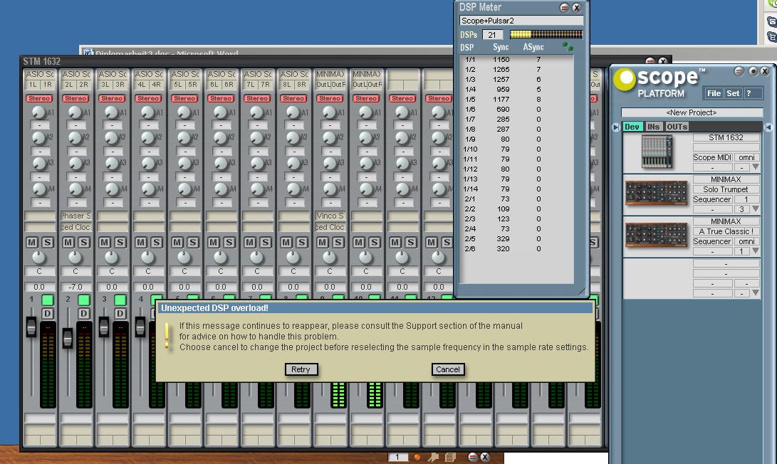

another thing that annoys me a bit is the dsp allocation error with minimax.
Don`t know why but it only happens when loading minimax. Prodyssey and all the other stuff works fine....
sometimes relocation on dsp works sometimes not....
here is an example: i got a standard setup (44,1 khz, ... )
when loading the first minimax the error appears but when i click retry, it is solved. But when I try to load the second minimax, the error appears but retry doesn`solve the problem.
but i still got round 8 unused dsp....
I would be happy if that could be fixed as well.
I cannot say exactly when this appears, but I think I did not have this error when I had 2xPulsar2(6dsp) installed.
So a reason may be the ScopePro(14dsp) and ScopeProject(6dsp) combination.

the reallocation bug isn't a bug.
depending on what devices get loaded, there may not be multiple dsps right next to each other, which is what a big device like minimax requires(latency issues between dsps). at least scope will reshuffle the project and load the dsps in a way that will fit, even if it's eventually. Pro Tools HD will just refuse to load, period, until you make a new project or buy more dsps......

garyb wrote:the reallocation bug isn't a bug.

it's not a bug on PTHD either, although you can believe even PT has bugs(all complex software has bugs, hence all the hotfixes). PTHD just doesn't allow partially loaded dsps to be used for other purposes. Scope tries to squeeze all the use possible out of the dsps the system has.
the problem, when you get that message, is that there isn't enough contiguous dsp space for the plugin(minimax takes a couple of dsps), so the system asks if you want to reshuffle to make room(giving you a chance to protect your work before trying). it's a GOOD message, in a sense...
