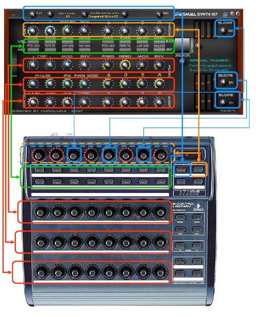

Just to illustrate the OSS 107 - BCR 2000 link, a picture extract from the quick manual I am preparing for you all ...
The main idea of this project was typically to test this type of hardware controller to scope link principle.
The idea is to use the scope device control surface screen as a visual extension for the direct sound design possibilities provided by the BCR 2000.
OSS 107 to BCR 2000 mapping.jpg (118.06 KiB) Viewed 4669 times
