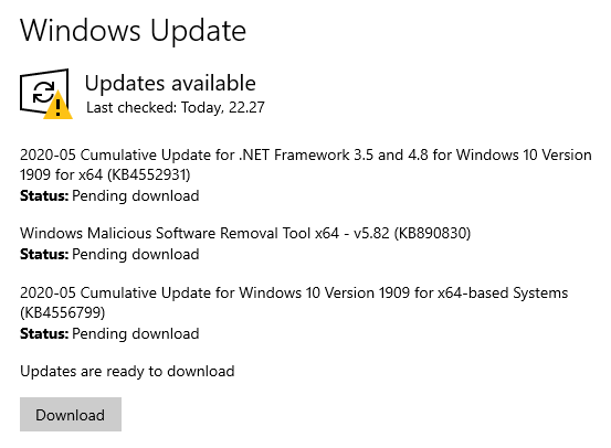

Seems like the newest cumulative Windows updates that Microsoft rolled out yesterday Tuesday have solved my problem with random clicks (Still holding my breath!!!):
ClickFree Updates.png (22.88 KiB) Viewed 43000 times
I wonder what it is in this update, that fixed the random clicks (still holding my breath)?
I'm now able to get lowest ULLI with the XITE on light projects, but I have to run my PCI cards at 13ms to achieve clickfree operation.
If I tax my system but keep it under 50%, I have to raise the ULLI to 4ms on the XITE in order to keep it click free. But the clicks I get are not random.
If I tax the system even further to 50%+, I have to raise the ULLI to 7ms on the XITE in order to keep it click free. But the clicks I get are not random.
I will report back after I've run a few more tests.

Windows 10 was fully updated all the time, every time I reinstalled Windows through these agonizing 6 weeks. It was the first thing I did each time. I made sure Windows was fully updated!
I have heard you repeatedly saying this many times Gary - I know! :) I have been following all your advice all time, but no advice or guide could fix what this recent update seemingly have fixed!!
The update that seemingly made the difference here (still holding my breath) was not available Monday night, when I last did a reinstall. It wasn't until late Tuesday night it became available here and I installed it immediately, and I have been running positive tests ever since.
