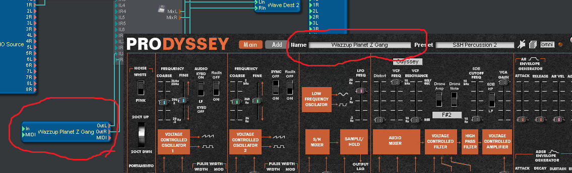

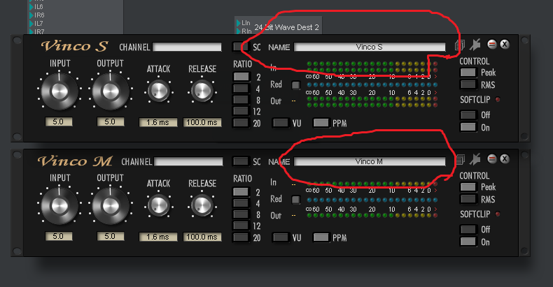

btw some small tease - i'm working hard to get us device naming on routing window for next 7.x :)

at the moment outside of ocean swift stuff i'm working on those tweaks i showed in the above screenshots and some mods to scope devices and was doing a lot of testing in the days before v7 came out.
