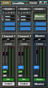

Hi There,asktoby wrote: Sun Jan 19, 2025 6:58 am
All I want is two stereo inputs and one stereo output.
(Why small? I'm trying to keep my routing window tidy and save MIPS)
I have been working for a while now to produce mixers with minimum screen footprints,
I am in the middle of developing a number of mixers to meet this need.
Here is the most basic one that should meet your need.
Press the 'Cntrls' button to get access to extra controls and to add Fxs.
I have not done a lot of testing as yet, so if there are any issues with the mixer please let me know.
regards
maus

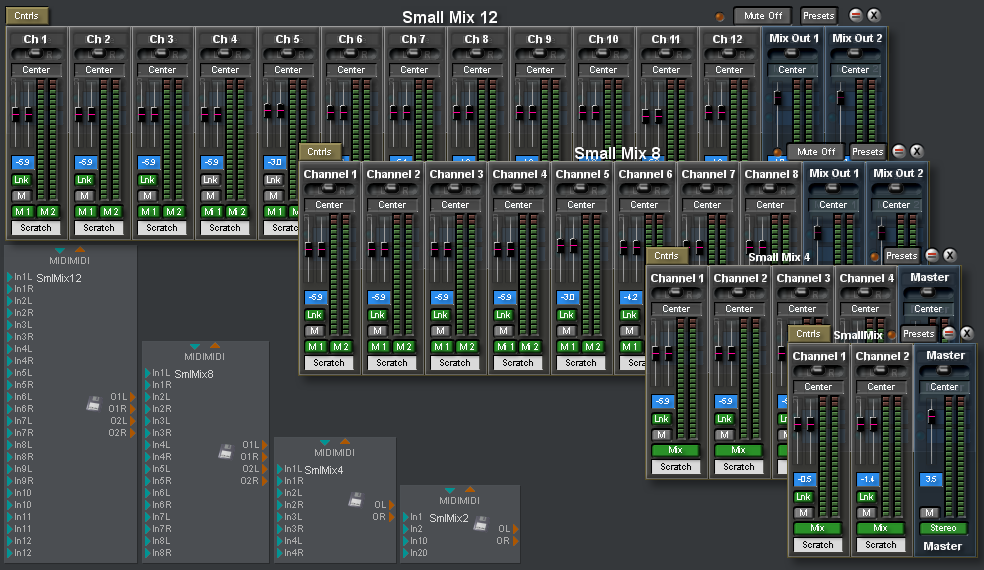

I am building a family of these mixers 2, 4, 8 ,12 and 16 stereo channel models.
Most are done, still working on the 16 channel version.
Also have not really tested them as yet.
regards
maus

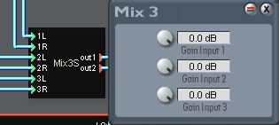

At a 1st glance, 3 - 4 channels would be good for me.
Currently I´m using "Mix3S" (see attachment) for summing of 2 small mixers and WAVE Out in my latest XITE project.
It works, but your new creation is more advanced in regards of control.
Meanwhile I went away from using a single big mixer.
"phase lock" on PCI would be great too but I guess it´s no biggie on my XITE-1 once the device is manually assigned to a dedicated DSP.
I´d don´t use for tracking/mixing,- instead I´m using for my hardware keyboards (A16U/ STM1632X), Scope synths and VSTis (ASIO 2 Ch.) on Scope MicroMixer,- and media player (WAVE).
That´s 3 stereo channels input for the summing mixer,- and when I´d use VST (ASIO) separately,- I´d need four channels.
So, I can´t wait trying a 4 stereo-channel version in my project !

Re: Tiny 2 channel mixer?
How tested are the current versions given above (Mix2)? I'll check phase.
I have run all mixers and tested most functions (controls, inserts, channel disabling, midi, presets, etc).valis wrote: Fri Aug 15, 2025 8:46 am How tested are the current versions given above (Mix2)? I'll check phase.
I don't think I missed anything but you never know.
Look forward to phase checking.
Thanks
maus

I still have to crank up the master fader more than the channel input faders,- also when these are @default levels.
The meter scaling seems to be wrong too and they should work like the meters in S|C mixers do.
P.ex. when I set the faders to 0dB or less,- there´s barely level at the stereo out and in the analyzer/level meter I use between SmallMix4 and the XITE main output.
Otherwise, everything works and the graphics issue (top of device) is gone.
Here´s the general level meter stuff from Scopev5 micro mixer manual:
I´d like to get this right, last but not least because DSP assignment/ASync on XITE is better w/ the same project and compared to SpaceF´s Mix3S.
I now hope I´m no too picky ...
And,- I´ll check the stereo switchers later.
