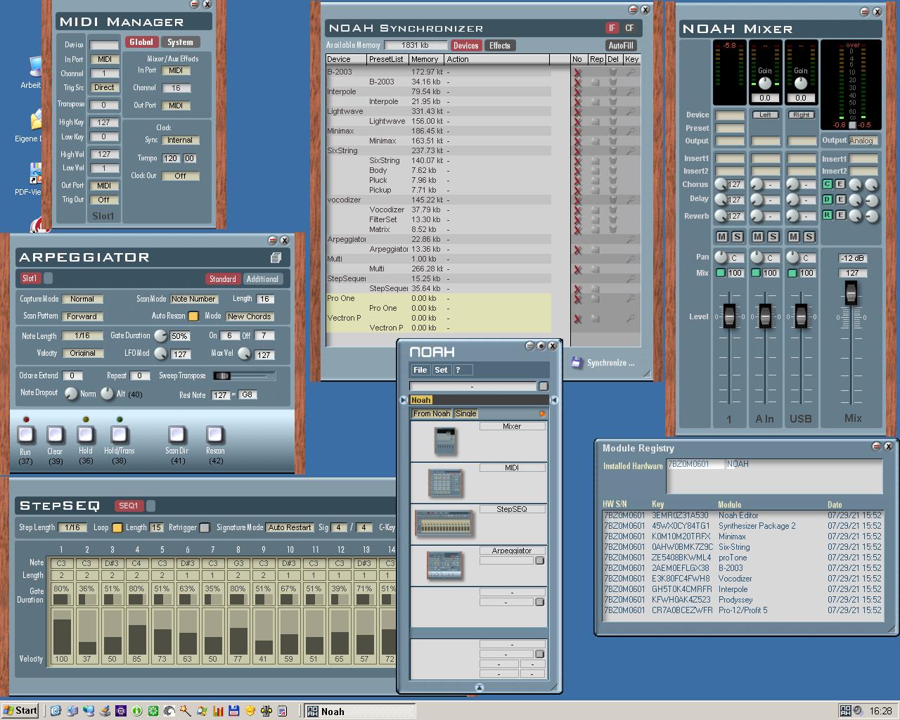

Here´s HOW TO install NOAH plugins:
1.
Create a shortcut on your desktop from this location "C:\Noah\App\Bin\PluginInstaller.exe"
2.
Drag the necessary OXE files to PluginInstaller.exe shortcut you created on the desktop
3.
You should get messages appearing from the application that you need to synchronize but it tends to take care of itself
Syncronization is IMPORTANT !
Here´s how it looks on my Acer WinXP laptop when successful:

I looked into my Noah WinXP laptop.
Nothing visible in add/remove software too.
No SCOPE uninstaller visible.
So, it´s all like it is on your machine, except,- everything runs fine here.
I investigated in the installed SCOPE application itself,- and when you go to Noah > application > app (I now hope that was the correct path) folder,- there´s a subfolder called "uninstaller app".
When you look into that folder,- there´s a .pro file.
But,- I dunno what to do with it ´cause I never ever uninstalled the Noah Remote Editor application from my laptop up to now.
And it seems,- EVERYTHING not being installed in the Win XP programs folder won´t be recognized in add/remove programs.
Consequently,- Noah being installed directly on C: cannot be recognized.
