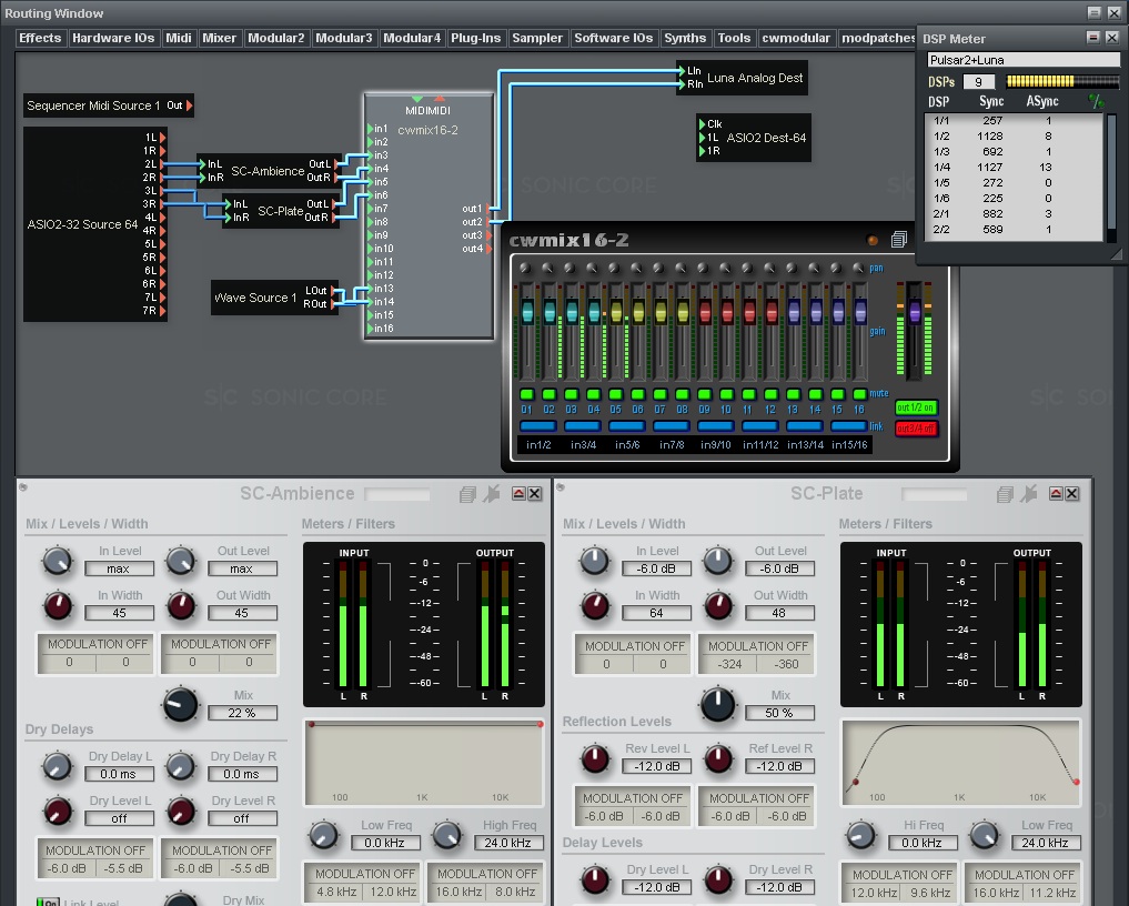

when is nothing else inside the project ecept those two reverbs I get this Message:
A capacity limit of your DSP cards has been reached. The specific cause is:
Not enough DSP memory: cannot connect
PC 256k Delay.out and nix.In

but I am talking about only two SC reverbs?
And I can load 2 SC Ambience together or Two SC plate together but not one Ambience and one Plate together.

But my question is why cant I load SC Plate and Ambience although I have 21 DSP´s?

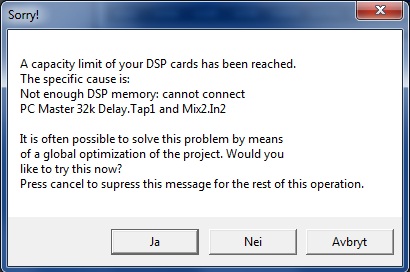

Re: cheap & effective PC for Scope
Tried.
1st attempt: Error message:
Pressed "ok" to optimize, working:
Tried once more, same error, optimize failed. Opened Samplerate settings, sitched master/slave once, working.
