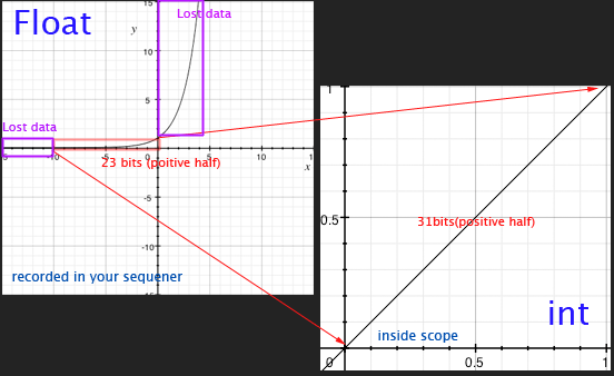

yes we are getting closer finally
of course exponent is signed (bi polar) otherwise you wouldn't have ANY way to represent numbers smaller than 1
thats not the issue. the question is how much precision do you retain by converting 32bit single precision float to 32int signed.
yes we have lost anything above 0 in the exp value which is exactly like loosing an entire bit (which kills your earlier argument just buy itself, since now we can only use 31 bits of info, and we have half the resolution just because of that. (+ - 2^30)), but thats not all because now you need to compute also the small numbers, too see they don't crunch into integer. since integer cannot reach the ultra low numbers float can produce. so my questions what happens to this range :
floating point range:
(1 / (2^23)) * (2^(-127)) = 7.00649232 * (10^-46)
to
to(1 / (2^23)) * (2^(-8)) = 4.65661287 * (10^-10)
this is the lowest number in fractional 32bit integer:
1 / (2^31) = 4.65661287 * (10^-10)
everything under that is lost as-well.
to
edit:
thats 5 bits, leaving us with only 2 bits of exponent for 23bits of data.
considering rounding errors, reduces about 1 more bit of precision (half)

afaik there is no way on earth to get the same resolution from two different ranges of the same bit depths.Single precision binary floating-point format
* Sign bit: 1
* Exponent width: 8
* Significant precision: 23 (24 implicit)
pure logic - no math.

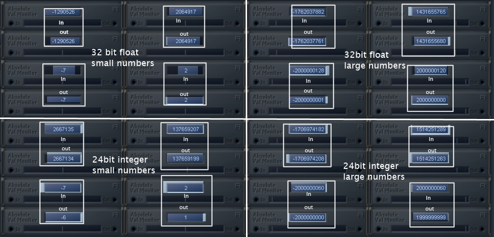

Re: Another thread about summing in scope
simple.
becouse 24bits has slightly better error correction at the top end.
look at this pic:
32bits float are better for silence (the stuff you don't hear) and teh difference between 24bits and 32bits is just by one point.
when you go to the high range (the stuff you actualy hear) 24 bits is on the upper hand with a nicer rounding algorithm that makes rounding errors of + - 64 points while 32bit float reaches errors of 128points.
both have the same precision and different rounding algos. this is the experiment i did on reaper. comparing 32bit float drivers and 24bit integer drivers.
look at this pic:
- 24bit-32float.gif (197.89 KiB) Viewed 2891 times
and here is a graph roughly explaining why this happens:
not that the zoom and selection size on the float side is not correct but in order to it being correct i would have to select sub pixels. so it just gives the idea across.
- graph.gif (37.12 KiB) Viewed 2890 times
my experiment shows that both 24bits and 32bit float have the same resolution after conversion, but the rounding is different.Knowing weather or not it is best to use FLT ASIO drivers is important to me and has seemingly gone completely uncovered. It seems to me to be a very fundamental question that almost all users of the scope environment can benefit from, if even just by a few rounding errors.
while you get more accuracy on the quiet parts of 32bit float, you get less accuracy on the loud parts. its a give and take situation.
i think you cant tell the difference anyhow, and it all gets converted to 64bit float inside the daw anyhow.
so to answer your question - if you are recording through converters - record at 24bits integer to keep exactly the same audio that got into the card. if you are recording a synth - record in 32bits float - to keep your sound as much in tact as you can (well it gets quantized from 64bits anyhow.) all the rest is irrelevant.
